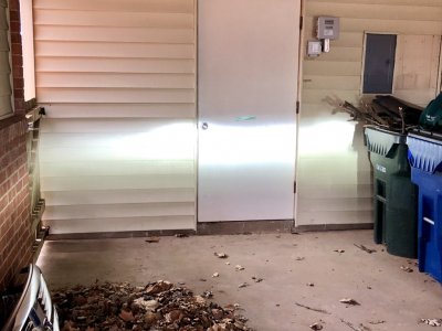

Any night shots? Curious how the cutoff is. Been looking at trying new led headlights

The hot spot is a little enhanced by the camera.

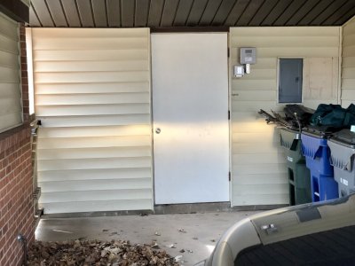

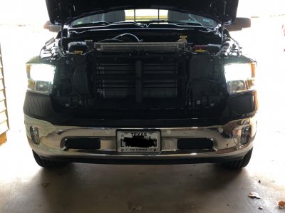

Below are a couple night shots I took. After a couple weeks these look the same as the day of install and I’ve had absolutely zero issues so far 17E107E0-F8E1-4D10-A9A9-F47DCC84ACB2.jpeg355D454F-ADFB-4360-BF01-D9B844D82A48.jpeg
