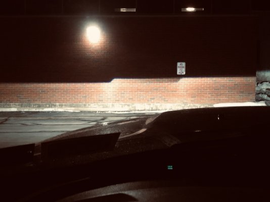

So I have been playing around with adjusting my alpharex novas on my 2018 ram and I still have that Z pattern going on, something I’m doing wrong?
crash68
ACME product engineer
Mar 20, 2016
12,351
21,485
3.0 EcoDiesel

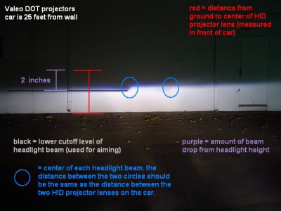

I'm guessing the Z pattern your seeing is the typical step in a projector.
Adjust them like this:
1500ram12
Jan 23, 2012
5,487
2,432
2005
5.9L Cummins
It's the cut-off of the projector. That's the way they are designed. Some are more pronounced then other's
