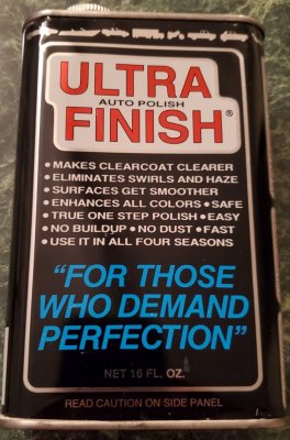

Try this polish it has a nice bite to it you wont be disappointed check out my thread
