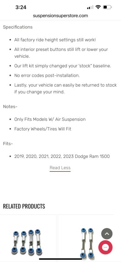

I have a 2019 Ram 1500 Laramie 4x4 with air suspension. I want to level the front. Does anyone have any recommendations? Or does anyone have any experience with these?
Brand new Ram owner and member. Any help or advice is greatly appreciated.
Ive never heard of anyone having any big issues with those, outside of the normal issues that come with factory air setup in general.
