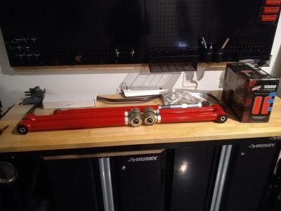

I actually got a decent return this year so I was able to order some parts.
On the way:
Inez 4/6 drop kit (I'm still on stock wheels/tires) so I'll probably go down to 3/5.
Waiting to install:
Core 4x4 upper and lower control arms and panhard bar.
Airlift helper bags
Helwig rear sway bar
Is there anything I'm leaving out? Has anyone installed the front sway bar? Any opinions?
