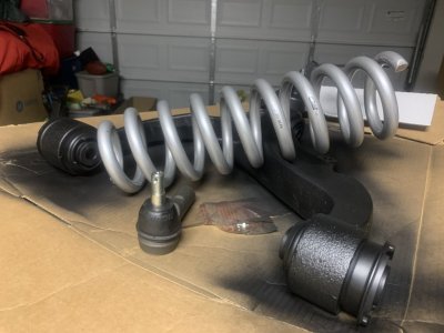

That stimulus and taxes just keep on giving back and the truck needs some refreshing so I’m starting on the suspension.
Complete:
Zone UCAs
Bilstein 5100s (@2.8)
Supreme Suspension sway bar endlinks
Moog front sway bar bushings
Icon +1.5” rear springs
Fox +3” “Adventure” shocks
Helwig rear sway bar
Teraflex +2” sway bar endlinks
Coming soon:
Eibach Pro lift springs (front)
Clayton Off Road rear UCA/LCAs
Clayton Off Road Panhard bar
Moog front lower control arms
Moog outer tie rods
I’m pretty sure I’ve covered nearly everything in the suspension. If I’ve missed anything let me know (might do some Core rear sway bar endlinks, but who knows).

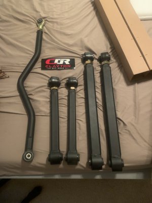

Rear UCA/LCAs and Panhard bar just arrived. Gonna be a sec to get under the truck with this weather here in TX this weekend. Just need sway bar endlinks and the rear will be complete (and quick to do).
They can still sell you the straigth trackbar. COR-4510110. The made it available again i think because we started asking for that version :)
@crazykid1994 went through the process. they can exchange it fairly quick for you.
Gonna run it as is. And Clayton is awesome by the way with their 2 day shipping from FedEx.
