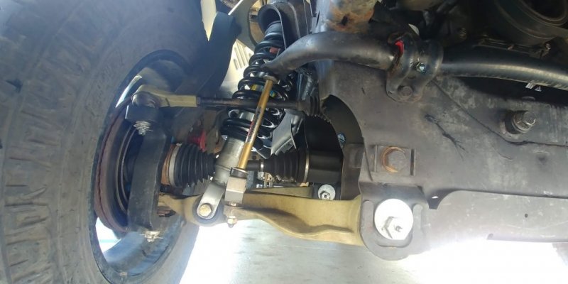

after doing the 5100s + ucas i installed the suspensionmaxx endlinks (https://suspensionmaxx.com/product/SMX-1319L). everything bolted up fine, and parts align ok (each side leans in toward the engine a bit and the weird top "wedge washer" or whatever it's called is properly indexed) but the geometry looks weird. the bushing looks way too pinched on the bottom.
i was in a rush (always a bad idea) so figure i'll unbolt everything when i have more time and try rotating things to see if it makes any difference. if anyone has good pictures of how these look bolted up to a rebel/ort (looks like our lower control arms are different, and also looks like the sway bar connection is different) with the 5100's or similar level i would appreciate it. just want to have a better comparison point when i'm under there.

Yours look like mine, which also look like his (and I believe to be correct):

Here's what I've got... super pinched on top. I've tried loosening everything up and rotating the bottom to affect the angle but it doesn't make much difference which way I go. Different than the video, but chose the current angle based upon interpreting the instructions in the box.
