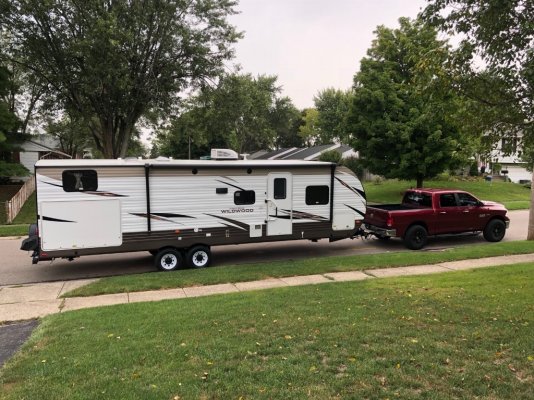

I have an Air Lift 1000 setup on mine along with the Equalizer IMG_0144.jpgc42e6b763c94ea9e8cfe2d213401c8c9.jpgE4 hitch with built-in sway control on my 2014 Ram 1500. And the factory brake control system. I pull 30ft. travel trailer that is 6950lbs.
