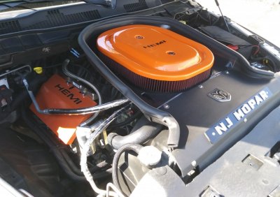

Well, I just installed mine and I love the way it looks. I had a little issue with getting the IAT sensor (which actually still had the o-ring by the way) in the new coupler as well as moving the ac line so hopefully it isn’t too crooked. Definitely easier to install than my S&B. Overall about 20 minutes worth of work for me, which included going back and forth into the house to get the parts. I also left the radiator shroud off until I can figure out how to trim it.

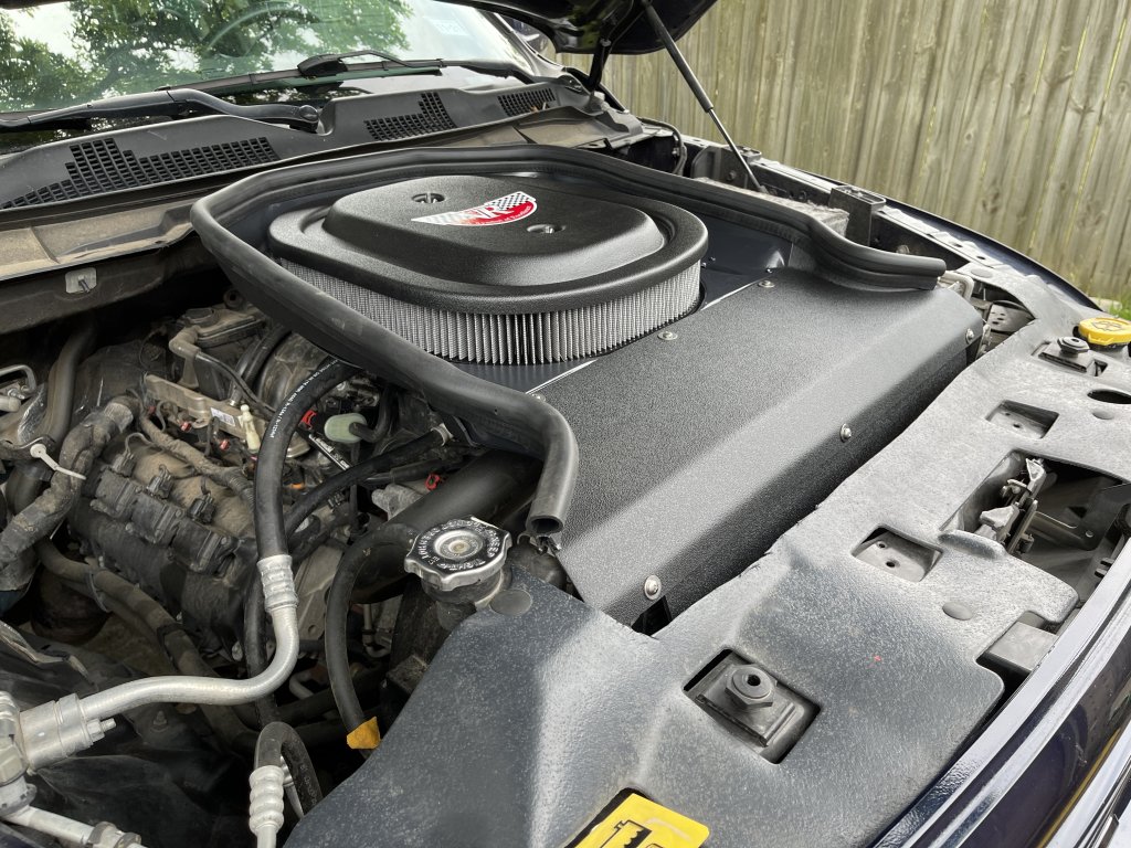

Look at my 2nd pic to see where I trimmed my shroud. Used tin snips to cut it. Leave enough to use the pins on both sides of the radiator.

Just now realizing I may have trimmed too much on the right side. Oh well, it's not hurting anything. Definitely has a little more throttle response in the higher rpms.
