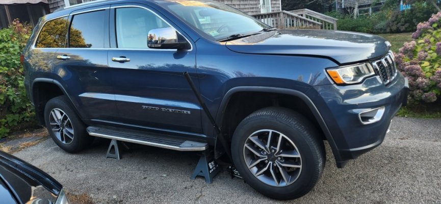

I encourage those with an 8 speed to change their fluid before the 60k ZF recommends. I changed the fluid in my wife's Jeep GC. 38000 miles on this fluid, 0 towing, 0 hauling, just several road trips and my wife's commute to work and back daily.
Up on jack stands. Without a frame this was not fun to get on jack stands.

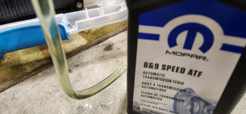

New fluid for comparison

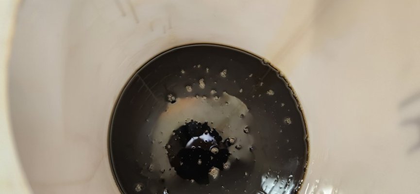

Magnets

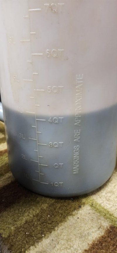

Got about 4.25 qts out of it and only have about 1.75qts back in before with it just running in park before I went in last night. Now if I can just get the last 2.5 qts back in after doing the fill procedure I'll be in good shape.
Thanks to @Wild one for posting the fill procedure for the 8 speeds.
If I can't get the whole 4.25qts back after doing the fluid check procedure, I'm going to tilt on it the drivers side which will hopefully drop the fluid from the fill plug enough to get it all back in.
Wish me luck guys :eek:

I just got 4.5 qts in it following Ricks sheet. It was completely dark out and I was just too tired to do it last night.
So I got 4.25 qts out and put 4.5 back in. Should be right because I'm sure the filter soaks up a good amount and I spilled some too...
Thanks again @Wild one !

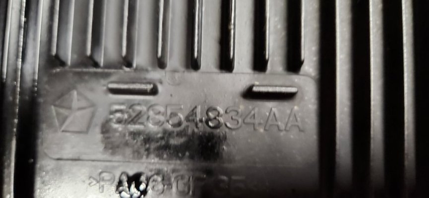

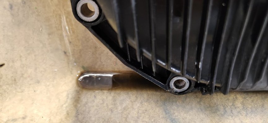

That's about right for the Jeeps version of the transmission.I haven't done one,but i've heard a few guys say the Jeeps take about a quart less then the trucks take. Can you post a pic of your old pan Hemi, i'm guessing it uses a physcally smaller pan,to gain a bit more ground clearance
Yeah everywhere i read about doing this on a Jeep GC said about 4.5 quarts so i should be good.

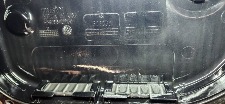

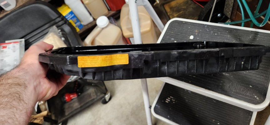

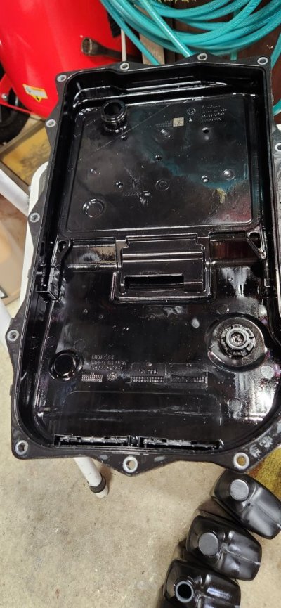

Here's a couple pics of the old pan. New one is the same PN but a B at the end and no drain plug so that will be fun next time. I'm thinking of drilling a small hole in the an where the filter is when I go to change it next time.
View attachment 550392View attachment 550393View attachment 550394
The pan does look differant,as it doesn't have a dropped sump,like the truck pans have
