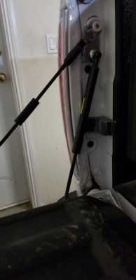

BWL
Embrace the skeptisism
Oct 14, 2017
8,847
8,915
BC Canada
Out of curiousity is it the correct side up. Members have had problems when they were upside down. This is correct.15397101418372065806530293995076.jpg
turkeybird56
Aug 2, 2018
25,566
56,162
Central Texas
YES, that is correct. To verify, just go to Zee Dee web site and watch video if U have ne questions, IMHO
Jrod
USAF 1997-2008
May 19, 2014
1,291
1,468
Virginia
2025 Laramie
SST SO
No issues with mine. I'd open and close the tailgate slowly and check if the cable interferes with the shock. You may have to make an adjustment.
