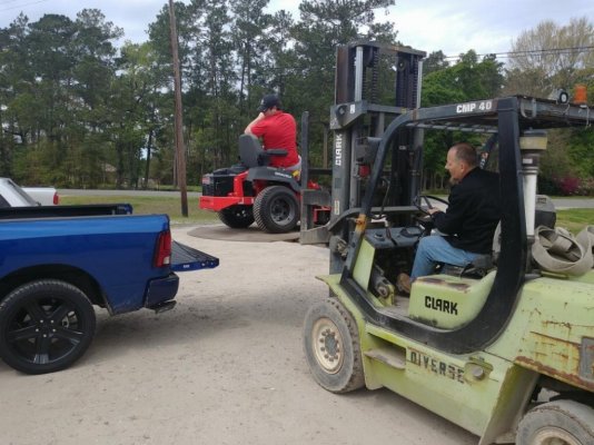

Pretty sure there is none, but I am curious as to what ya'll think. I will be picking up a new 800 lb zero-turn mower tomorrow. The mower will fit inside the bed. They drive it off of a large steel pallet into the bed using a forklift. I plan on being present during loading so I can make sure they don't drive the mower "onto" the 'gate, or even "rest" the pallet on it. I have a 2T engine crane at home that should reach to the CG of the slings with the tailgate still in place. But! If it doesn't, I'll either need to pull the ass-end of the mower out onto the 'gate a bit or scratch the engine crane and go buy a chain block.

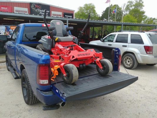

Well, that went...well. Pick up was great, trip home was a little "nervy", especially going over our 180' tall Rainbow Bridge. The only thing holding it in was 4 HF 400# ratchet straps and the mower's parking brake. Getting it out was more of a chore than planned. It was loaded ass first because it wouldn't fit in the bed with the 'gate closed and I didn't want the CG over the 'gate. That made getting the engine hoist centered on the load impossible. We ended up pulling the front wheels almost off the 'gate before it actually started lifting clear. My neighbor came and drove it off the plywood skid set on the crane legs. Good thing because my first "driving lesson" was for ****. I'd have prolly wrecked the mower and my truck backing it off. These things have a pretty steep learning curve for an old guy...
