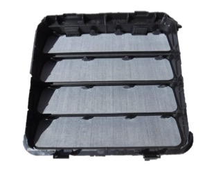

After doing a little research I learned about "Rear Cabin Vents" failing and allowing water to enter the interior behind/under the rear seat. I removed my rear seat and all the padding/carpet under/behind it. The amount of dampness was incredible. Upon inspecting the Rear Cabin Vents I discovered them to have both failed and missing multiple flaps allowing you to see outside and the front of the truck bed.
I ran a water hose on top of the truck cab and as the water ran down the rear window and down the back of the cab it was pouring in/around the two Cabin Vents like the "Titanic after striking the iceberg"... I pulled the vents and discovered even worse deterioration and failure. The outer seals were hard and split in multiple places, and the remaining vents flopped in the openings without being firmly seated. With the Vents removed I decided to tape a piece of clear plastic over the opening to show the amount of water flowing down and over the Vent area. I cannot believe that there is not any type of a shield/cover above the outside vent areas to divert water from these areas? A simple awning would go a long way in preventing water from entering the cab when or if the vent failed. Of course a better made vent is needed to completely seal the cabin from both water and dust.
To end this frustration release, I have ordered replacement Cabin Vents that are supposedly improved to prevent this from happening again. They have yet to arrive but once they do I will install and run a test. I have temporarily taped both Vent Openings up until I have the new Cabin Vents and will have to crack a window when closing doors or running the a/c or heater. I have not re-installed my rear seat, padding or carpet. Follow-up report to be posted after installation and test. Fingers Crossed.

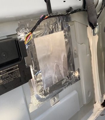

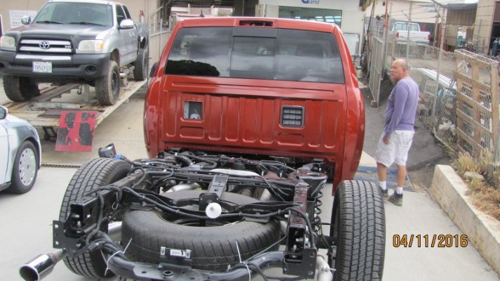

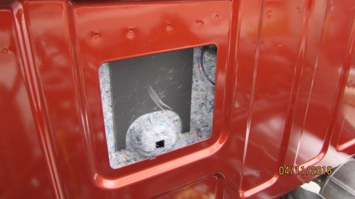

It would be interesting to track this cabin vent failure thing based on cab configuration. I wonder if they fail equally between regular, quad and crew cabs? I know a lot people with later model Rams and none of them have ever mentioned issues with this. I've only seen it online. I know I've battled both the 3rd BL leak on both my 2017 and 2019 classic and a leak from a shoddy rear window install on my 2017 (quad cab)
Regardless, it's crazy not to do the 'rear seat mod' if you're pulling the rear seat to replace these vent 'check valves'. Tons of threads here on the rear seat mod.

A picture came to mind after the post about rear seat Mod
Are you sure that you don't want to hide your arsenal behind there ?
Most ppl that do that Mod, are installing stereo components back there
