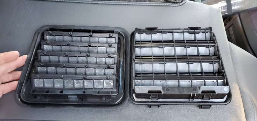

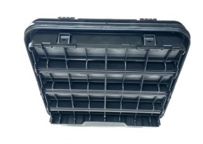

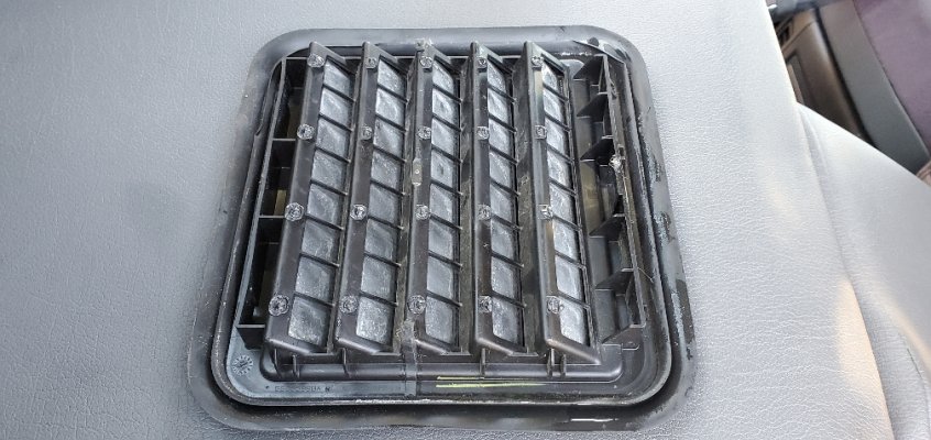

I received the Replacement Vents today - Mopar Part Number: 68323649AB. I thought that there would be covers of some sort on the outer portion of the vents to protect the flaps and help divert water away but there were none on them nor can I find any additional part to order for them? Makes no sense to have the flaps exposed directly to the elements?
Interior Side of Replacement Exhauster Vent
Exterior Side of Replacement Exhauster Vent
Interior View of Exhauster Vent Opening with added sealant
Mopar Exhauster Vent Pt No. 68323649AB Interior Side Installed and Sealed.jpg
Installed Exhauster Vent with sealant around edges and surrounding open seams

So do you feel the new part is improved in any way or is it the same thing in new condition?

Having replaced mine, the new parts are definitely an improvement.
It has a new style Seal for the Vent Exterior outer edges to the actual truck metal back and a "gutter" style lower on the interior lower side to catch water and drain outside. It is better than the old design but I think it could have had a cover for protection to help it be better.

They cost $6.50 each from Mopar Parts.
68323649AB - Bodyside Aperture Exhauster. $6.50 2 each $13.00 Total

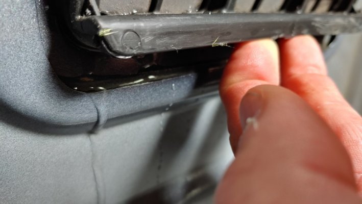

So I read thru this thread weeks ago and ordered the new vents as a preventative on my 2013. Got them in last week, went to go install them after work today and found my vents are totally different. IMO they're a much better design than the "new improved" ones. They have louvers on the outside to divert water away and they have an extra seal on the outside of the vent. Ended up leaving the factory ones in since I never had a leak from them. The PN on the factory ones in my truck is 55055998AH. Pretty sure on the H but not positive.
Guess I have some extras if they start to leak in the future....111d0ba1de969bdcee3bde5d857c5bb4.jpg5e4a20df4a77e033db83054bbae749f5.jpg
