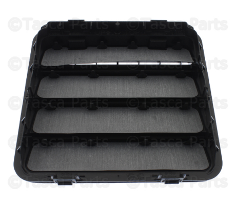

So I read thru this thread weeks ago and ordered the new vents as a preventative on my 2013. Got them in last week, went to go install them after work today and found my vents are totally different. IMO they're a much better design than the "new improved" ones. They have louvers on the outside to divert water away and they have an extra seal on the outside of the vent. Ended up leaving the factory ones in since I never had a leak from them. The PN on the factory ones in my truck is 55055998AH. Pretty sure on the H but not positive.
Guess I have some extras if they start to leak in the future....View attachment 458909View attachment 458910
View attachment 458911View attachment 458912
When I search for 68323649AB on line the images show a plastic louvered cover for the outside of the vents.... Similar to what is shown above.
Those of you that bought these updates ones don't have that?

That's the updated part. The original has 9 little rubber flaps vs the new has 3 larger ones.

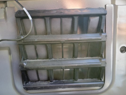

2014 Model here .... just found the "second" source of my water intrusion too (second because I've already fought with the third brake light on multiple occasions).
Unacceptable Ram Trucks. Unacceptable.

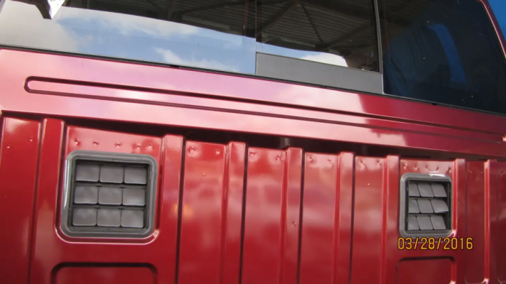

There are Youtube videos that show how to do it
i recall that first you insert a corner in first, into the bottom center
old style, this was a brand new 2016, that i was changing colors on
New style
