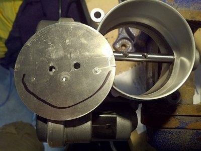

Throttle plate removed and now knife-edged (not pictured). Hope to polish the body itself tonight; nothing mirror-like but the boring marks are quite rough.
I don't think half-shafting is a good idea for a family DD so that will stay.
God, I love playing around with stuff like this :rockit:

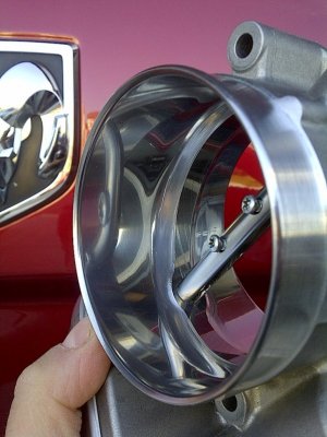

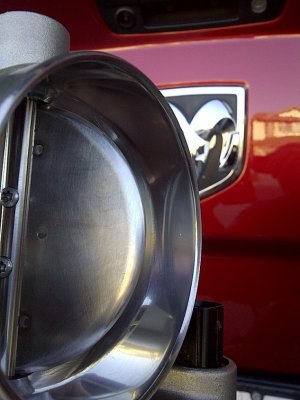

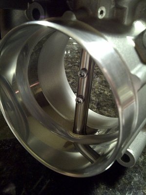

Finished her up yesterday.
Knife edged the throttle plate, polished the inner TB body out to a pretty good shine, port matched it to the intake manifold and loctited the screws in. While I was port matching I also got rid of some nasty ridges inside the throat of the manifold.
I was under no pretense that would make more power, but it was free, took a couple hours while I had it out anyway, and can't hurt.
Started her up after an hour of battery disconnect time, no lights, no stumbles.
Feels like she wants to pull harder, breathes a little easier now. THIS is how I expected it to feel when first putting the 87mm on.
One shot shows the polished side after 2000 grit vs bored finish, another the knifed plate and the other shows the shine. If you've seen the inside of a bored TB you'd know the difference. The hone marks were thick rings inside the body you could nearly play a tune like a washboard with. I could have kept going but thought enough was enough.
