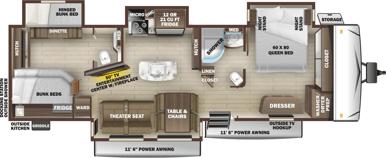

Alright, so I LEASED a truck. I went and picked it out based really on existing stock - because thats what was there, and in this climate thats the options I had.
I ended up with a 5.7 Hemi 2022 Black edition. Super happy with it, chose it because the sales guy was telling me I could pull 11,700lbs with it (and the whole reason I wanted a truck was to get a TT).
Today, after months and months of searching, negotiating...I find my TT, put my paperwork in, all is good. Was planning on driving the 5 hours to go get it during this upcoming weekend.
I looked a long while, because I REALLY wanted a place my kids could call 'home' more than just a dinette that folded out, or a jacknife sofa. I settled on a MR338BHS. It's a heavy beast, but I wasn't worried. I didn't anticipate driving all over, as the truck is a lease - but perhaps a few intrastate trips, even parking it at local spots just to enjoy some time away from the kids mother (we're no longer together). Huge perk of my job is I can work from anywhere, and I sometimes travel - so I also figured on semi-local trips I'd tow the thing to the job site, and save on hotel, flight, food expenses while 'on-site'...while enjoying my own 'home away from home'. Win/Win/Win.
After talking to the salesperson about the weight...her hesitation was warranted - 10,700 is the weight of the trailer. Her concern was I'd be overweighting myself, and fair enough - but I've got two small children and no significant other, so payload should be alright - and I live fairly minimally, but would use this thing as an off-grid home replacement - so I'm not pretending I need to pack up all the outdoor activity things, the coolers full of XYZ, the fishing gear, the bikes....
So just to confirm, I go on the RAM website....I see the VIN lookup for towing capacity....type in my VIN and realize -
I've got the 3.28 gears.
Anything I can do about it...:( or back to the drawing board, while hating my salesman for not knowing jack **** about my truck?!

Hate to say it but that TT is too much for a 1500, even with 3.92's. Pretty sure you will be over GRAWR and likely GVWR. Definitely in 2500 territory here.
One thing that is often stressed here is never listen to a salesman (either truck or RV) when it comes to towing capabilities. Most don't know or are just trying to make a sale. They see a tow capacity of 11,000 and think that truck can tow it when they are unaware that you are over on GRAWR.
Site says 1060lb tongue weight. After loading it up will likely be closer to 1300-1400lbs. Not sure but think that is already over the limits of a Class IV hitch? My step-son had a 2021 Grand Design Imagine with 1100lbs tongue weight (CAT scale verified) and he was 200lbs over his GRAWR on his Tundra. And at 40' overall length it will not be fun or comfortable towing that with a 1500.
My advice is to get a bigger truck or a smaller TT.
Sorry to be the bearer of bad news

well, given that it seems i can now tow 8230, with a payload of 1848 (sticker verified) what are my limits? im 200lbs, the most the passengers ever will weigh are 100lbs extra (small children, so i guess in a few years we could be looking at something bigger, but by then i'll get a bigger truck)
what would be the ABSOLUTE HIGHEST i could go? i've been looking for months, and was about to bite the bullet on a few models but were in the 7500-8000lbs range. i just happened to find this one that was 10,700 and with full size appliances, i fell in love.
I'm still learning this whole endeavor of tongue weight/payload capacity...i have a class A CDL and drove over the road for a few years - but axle weights and overall weights were what was the hard part there. if my load was centered - i was good. but i guess then again, i never had to BUY a tractor or trailer, they were provided :p

If this is the travel trailer you are looking at, you'd need at the least a 3/4 ton as others have said. The dry weight for that trailer is 10,110 lbs!
If you are going to go with the 1500 I would look at a travel trailer with a dry weight (unladen weight) starting in the 5000lbs. weight range that has a gross weight rating in the 7000lbs range. You should be able to find one that will suit your needs.
