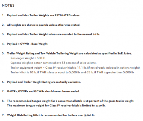

Well, I tend to agree with a bunch of these comments re truck size... but will weigh in on some of the comments re towing capacity... See the attached chart... I have a 2017 Ram 1500 4x4 that i ordered in late 2016 - with a plan to tow a 31 Ft 5th Wheel Trailer... the truck was ordered with pretty much everything but the kitchen sink, - trailer tow pkg, trailer brake control, air suspension, and an 8 speed trans with a 3.92 rear end gear. Our trailer is 9,800 lbs per the rating plate on the trailer - and I'm sure that it tows more than that considering what my wife loads into it. I have taken many shorter 250 mile (400 km) trips per year, and 2 very long trips - one to Dryden Ontario from London Ontario, Canada, and to Prince Edward Island (both trips are at least 2,000 km (1,200 miles) one way... with no issues - truck in tow mode runs 2100 rpm @ 55 mph (90 Km/h) and does not constantly shift in and out of OD. The big difference between this truck and my 2011 was the 6 spd to 8 spd trans change... both were 3.92 rear gears... with the same trailer. I have pulled a 34 ft TT to the Michigan Nascar races with the 2017 truck - yes - it was like pulling a stump... but no control/maneuvering issues when properly equipped with the equalizing hitch... the long chassis (crew cab) with the 6'4'" box makes a considerable difference in towing (the '11 was a Quad Cab 4x4 - 6'4" box).
In summary... if you are willing to spend almost $110K CDN on a 2500 for an occasional outing - go for it... And FYI, Dealers do not know how to order a pickup truck for real towing purposes... Best way is to factory order it... Good luck...
Good info but I can almost guarantee you are way over on your GRAWR. Most 1500's are in the 3900lb range and with a 9300lb TT we had 4160 on the rear axle

I have a 2020 5.7. I tow a 24ft hybrid TT that's about 4 to 7000lbs with minimal issues. You can go up to 12000 with the class 5 receiver hitch
The 1500's should have a Class IV receiver, not V. According to FCA, tongue weight is limited to 1100 pounds. Your trailer is in the sweet spot for the 1500's, it pulls very nicely.
