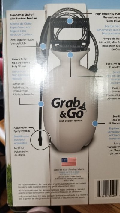

a garden sprayer (made in usa nice!)

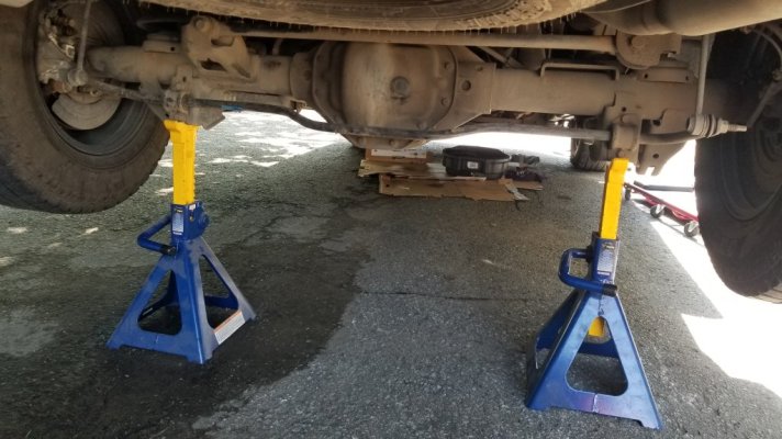

already had 8mm allen key, floor jack and jack stands but had to call in my buddy with 7 ton Jack stands because 3t were no where close to being high enough to get the trans level
did not buy a filter/pan yet because ive going to do at least 2 drain/fill before changing filter

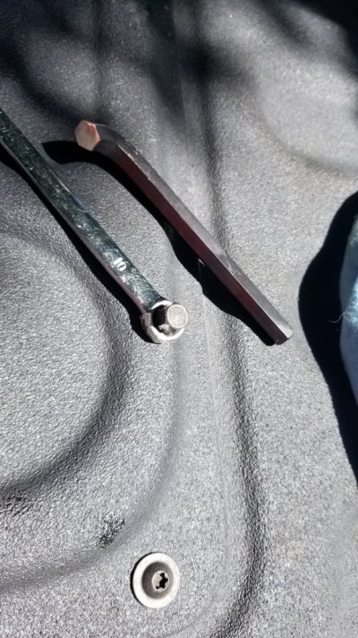

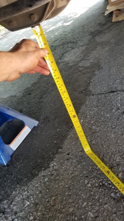

so for starters needed almost 20 inches under the diff to get the trans level. didn't have a real bubble level but used phone app and eye. made one correction (higher!) and it was looking good
now for the special tool part. i goofed up on this one lol. i bought a nice new 10mm key to sacrifice (i seem to remember reading people shortening allen keys to make it work)
so i started shortening it on the small end only to realize that it was not going to work like that. so i took one of the parts i cut off (a bit under 1/2") and taped it in a 10mm wrench and it was perfect
so i could have just taken that off the long end of my allen key and saved the working end lol oh well

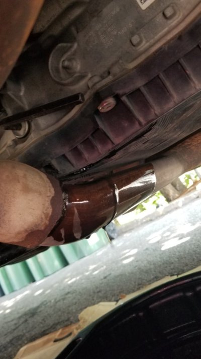

the original oil as expected was definitely dirty, no extraordinary smell. transparent dirty green if you dipped your screwdriver in it and dark grey and murky looking in the tub
interestingly i only got 5 litres in and out. and i only measured at the end when i put the used oil in the container it was full to the brim and when i put the leftover fresh oil back in the second container it was full too.
admittedly i only let it drain for about 15 minutes. enough time to go get cold beer in the fridge and drink most of it haha

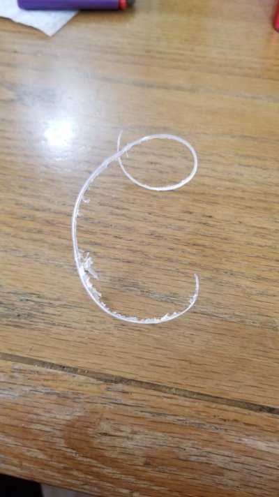

oh and bonus pic of the nice plastic debris i found in the bottom of my new pump! that long curly piece and a bunch of plastic sawdust. i flushed it out with some old atf+4 i had lying around.

3 canuck gallons (5l jugs haha) of valvoline maxlife atf
a 10mm allen key to sacrifice

View attachment 547152View attachment 547153
View attachment 547155View attachment 547156

View attachment 547215View attachment 547216

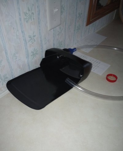

Thanks for doing this. I'm currently gathering up a few tools(3/8" torq wrench, 3/8" drive metric/sae allen head sockets).
I've most of the stuff to do the job as you have shown in the pics, my jack stands are old and I should most likely update those.

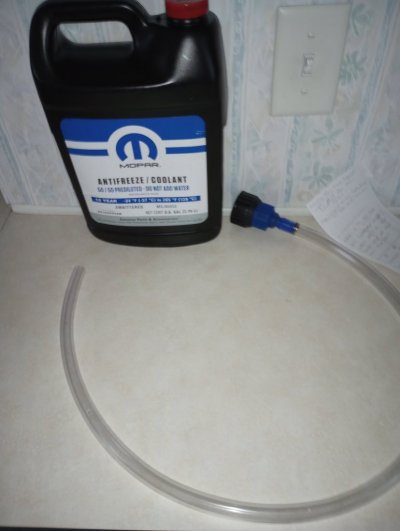

I made an "oil catch all" from an empty one gallon anti-freeze jug with a plastic open/close valve(from O'Reilly's)that screws on to the anti-freeze jug with 3/8" vinyl tubing attached that is long enough to lead into the drain pan.
I modified the one gallon anti-freeze jug to be able to slide it up and in-between the transmission pan and cross over exhaust pipe to catch the transmission fluid when draining... idk if it's going to "pan out", but it might just do the trick without creating much of a mess.
I'm still procrastinating doing this, but will eventually get around to doing the this.
Nice write up, again thanks.
I modified the one gallon anti-freeze jug to be able to slide it up and in-between the transmission pan and cross over exhaust pipe ... idk if it's going to "pan out", but it might just do the trick without creating much of a mess.

I like the idea and if you had no drain plug your catcher would be perfect when tilting the rear of the pan first it would catch the big pour
but i have to say i have the stock under-transmission crossover exhaust and there is very little room to work between the pipe and pan, even with the nice little flattening on the top of the pipe. i feel like i would have a hard time getting the drain plug out of the way quickly and efficiently with another thing in the way.
maybe just me but i would probably make more of a mess than just letting it drain on the pipe.
like you can see in my photo of the plugs (almost done draining at that point) the oil never went futher than a few inches past the side of the pan on each side. i layed a carpet of old cardboard boxes to be 1 foot wider than the very standard round black plastic drain tub and almost all the oil went in the pan! worked out well.
a quick brake cleaner hose down on the pipe after i cant say i saw or caught the odour of any smoke.
