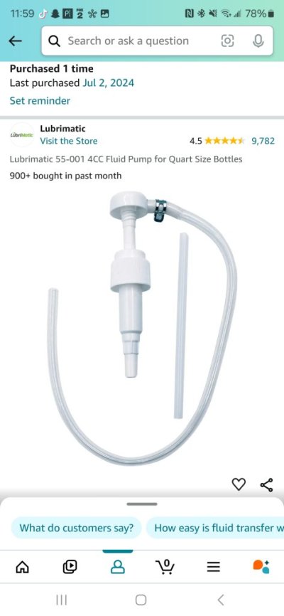

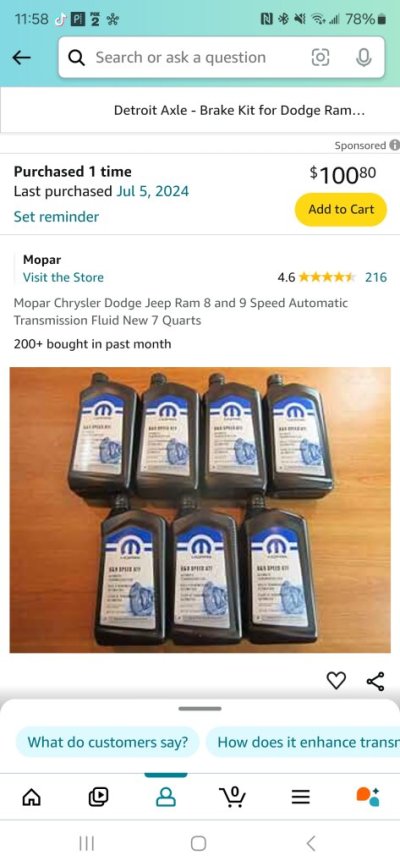

Don't use anything other the this fluid or the zf lifegaurd. I can get you the link. And I got my pan from A1auto and it was only 56$ and it only took me like a hour. But if you valvoline maxlife atf you will mess up your transmission I have family and friends that work at shops and they just had a trans that was locked up because of wrong fluid

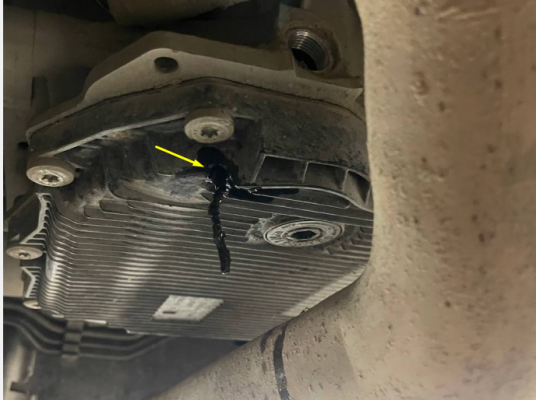

I went with a small cheat last time I was changing the oil in my 8HP70. My drain plug was stuck and if I tried to force in open I could feel the plastic giving in. So as I had the new pan with the filter right there, I just drilled a small hole in the right rear corner of the old pan to get the fluid out.
It's amazing how not messy can this job be, when the pan is really empty. I left the exhaust on and still not a drop on the floor.
Basically, all you have to do is find a sharp drill preferably with a pointed tip (I think these are for wood) and make sure you don't push it in, just very light pressure as it goes. Maybe even put some electric tape on the drill to act as a stopper and eliminate even remote chances of the drill contacting the transmission internals.
The pan is discarded each time, anyway.
I thought about doing this on my last service as the "new and improved" Mopar pan has no drain. I couldn't bring myself to put a bit through the pan in fear of "what if I hit important parts on the other side?". I elected to just do incremental backing off of the bolts and let it drip.
