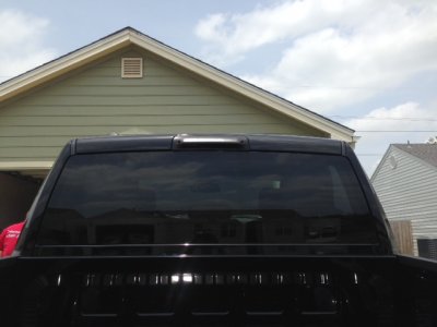

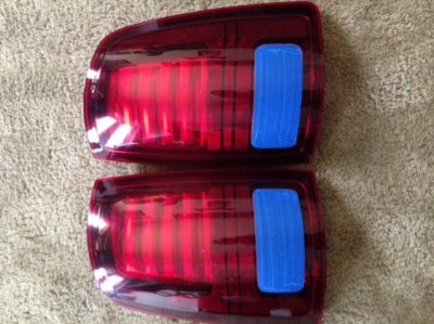

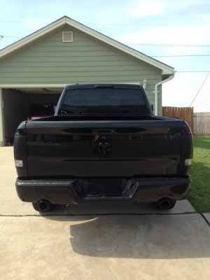

I blacked out my taillights and third brake light today. It wasn't as hard as I thought it would be. I would like them to be a little more gloss looking but I do like the way they look on the truck. I may have to redo them came out darker than I expected. I will drive with them like this for a couple week and then redo them. I actually liked the shine they had before I wet sanded them and put the clear on. Let me know if anybody has any hints to bring out the shine a little more. Thank you

Interested to see how it affects the light output and reflectors at night?
Looks cool tho!

My truck has the stock LED taillights and they have a little tint to them to begin with so I only did 2 coats. It came out a little darker than I thought it would, but it during the day the lights are visible so I will take a picture tonight and post it up. Masking off the reverse lights was the hardest part. Maybe because my OCD kicked in and i wanted it perfect.

3 light coats tint/3 coats clear......wet sand with 2000 grid then polish

That's the exact video I followed to do mine. Don't get me wrong they look great just wishes they had a little more of a gloss look. I think I may try to wax them a little more while they are on the truck. After I am done with these I think I am going to pull my headlights apart and paint the housing.

I don't know if you hand polished them or with a buffer. I did some on my last vehicle and spent an hour or two hand polishing and wasn't happy. Used a buffer and polish and made it look a ton better. Then I put a coat of wax on top and they looked like glass.

I polished by hand for about a hour on all 3. I will have to see if someone I know has a buffer if not I will have to swing by somewhere and grab one. I am going to redo the third brake light and mask of the cargo lights I like the look of blkexpress light.

I have seen others online get good results from a Mothers power ball on a drill with a non abrasive polishing compound. Don't use a rubbing compound, as it could introduce new scratches instead of filling the ones leftover from wet sanding and look dull.

I am going to go by the store pick up the plastx polishing kit. It comes with the polish and a drill attachment and see if I can get them a little more glossy looking. Thanks for the info guys.

Don't use a sealer / wax on them for a month or so.
You have to let the paint out-gas.
Often times a dull finish comes from not following recoat directions, allowing too much (yet then, not enough) time between coats. The flash / cure times on things like this are super important to get good adhesion between coats.

Add some red LEDs on the front or back and call it your night rider. Looks awesome
