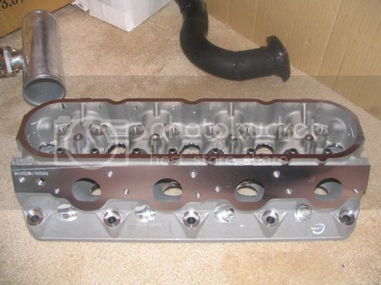

The first motor in the truck will just be getting headstuds, l92 heads, rod bolts, and a turbo cam with LS3 intake...otherwise stock crank/rods/pistons.

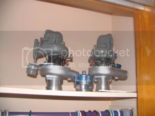

Debating doing twins since i have almost everything to do so, Or sell and go with a large single.... opinions?

If you already have the twins and every thing why not? Looks like a cool build though.
well my camaro is twin turbo, my cummins is twin turbo...was thinking of going single in the little ram just to try something different...im not sure yet..

You have a point. I big single can make just as much if not more than smallish twins. Are you going to make it a front mount? Or a rear mount setup?
Front mount, with an LS under the hood, there will be TONS of room in the engine bay to do damn near anything, battery will be in the bed.
I could always use a little nitrous for spoolup at the track to avoid having to be on the transbrake for 30 seconds haha.

You said it before I got a chance to. Single turbos show good power uptop once they lite but a small 100 hit of spray will lite it alot faster. What sizes do you have at the moment off the car? The single 88 on the Jeep at the shop takes skill to get it to lite off a launch, where as the twin 66's are snappy.
