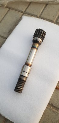

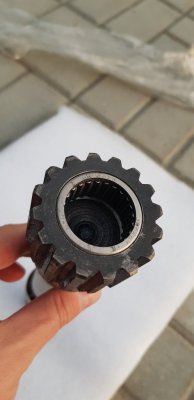

Here is the photo of this shaft. It is made for my Ram in Russia, Tomsk.
It is made from 3140 steel, and forged afterwards.
The price is about 300USD.
And the inner cv joint is rebuild with the more tight inner splines, so there is no play at all after the install.

where did you order the shaft from

Just an FYI for future onlookers, you can now buy this shaft many places online, including amazon for like 80 bucks.
