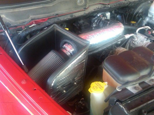

IMO. the IAT is a sensor that plays an important part in the constant changing tune of your engine using real time inputs. It is set conservatively and can be adjusted to suit individuals setups. I used a AeroForce Interceptor gauge to monitor IAT and ambient temperature and settled on 20 degree offset. The colder the inlet air the more timing is seen, this will lead to fuel knock if taken too far or if premium fuel is not used. I chased my tail with this trying to eliminate knock at one point not realizing I had created the problem myself. When I converted to a stand alone PCM I learned the importance of having accurate inputs as they all contribute to the quality of the tune. I now recommend the sensor be well insulated and place close to the mouth of the Throttle body. The SRT style IAT has a longer stock and IMO less susceptible heat soak from the engine heat. Under hood temperatures sky rocket when sitting still. I would recommend getting the coolest air possible to the intake rather than adjusting the IAT.
Ugly but works pretty good.
