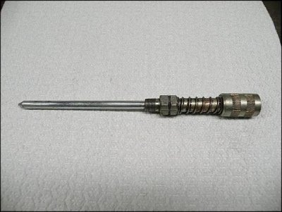

So I did a little research on another site. It seems this is the part you are all looking for. The rubber/plastic tip fits into the concave portion of the zerk and will seal as you pump grease through the fitting. I do not have any experience with this personally but didn't see this option discussed here so I thought maybe this would help some of you out.
http://ecx.images-amazon.com/images/I/21PNv3JgIKL._SL500_AA300_.jpg
(copy and paste to your browser)
you can find it on amazon - part #LNI 83278
Also someone had said that using old fashioned lever grease gun made it difficult to apply pressure to fitting and still be able to pump lever on the gun so he tried this product and when you push the grease handle it applies pressure in the direction of said fitting. You could also opt for a small hand held grease gun as well I guess.
https://www.amazon.com/Oregon-Chain...80445460&sr=1-1&keywords=chainsaw+grease+gun'
Again, no personal experience but another option to try.

that is similar to the one I use, except mine does not have rubber tip. got mine at harbor freight. I think they might have them at a bike store, too.

I took a grinder to my needle and flattened out the end. There's only about 1/8 movement in the fitting and I wanted to make sure all the grease was going in. Have to do it again when I change the oil in Feb. Once you've done it it is easy afterward.

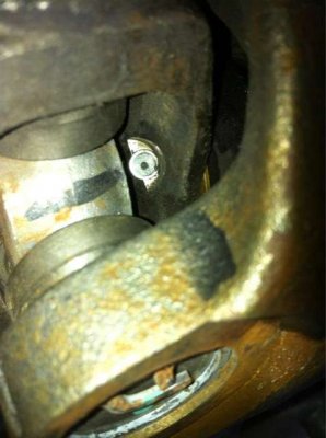

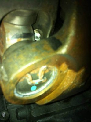

Guess I forgot I had taken pics when I did it. For anyone that stumbles on this post in the future, hope they help.
I took a small but long flathead screwdriver to clean it off. There was quite a bit of dirt on it. The grease on the other side came out uniformly and made a nice ring.
