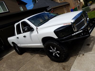

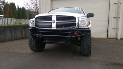

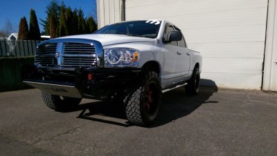

Some pictures i have of the truck at this stage and ill edit my 60k mile post and throw in a another pic i found. The picture with no skid plate is when i took it off to powder coat it and i thought it was a funny picture so i took it lol

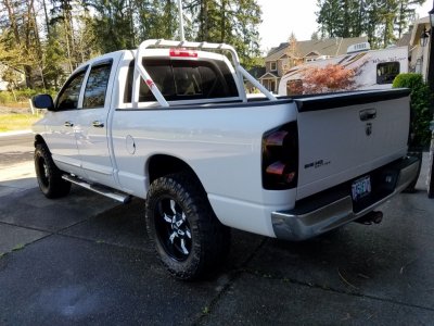

#2 i taped off the clear half moon reverse section of my tails, scuffed them with some sand paper and tinted with VHT nightshades. i did many coats so they were BLACK. I had read that you did not need to clear coat VHT and even that it could mess up the VHT so i let them dry for like 2 days then installed. They looked AMAZING IMO....... For a short while lol. People that say you dont clear nightshades are dead wrong i dont care what they recommend, it WILL fade and look like crap after a while. Ill post a pic below of the exact same tails, only diff. is about 1 year of time and you will see the huge difference. Went from a gloss black to a rough looking ugly flat cherry. Take it from me and clear coat your nightshades :favorites37:

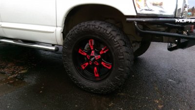

I also forgot to mention i removed the wheel spacers when i got the new rims, i didnt want my wheels sticking way out anymore and with the new bumper i had no reason to keep them on

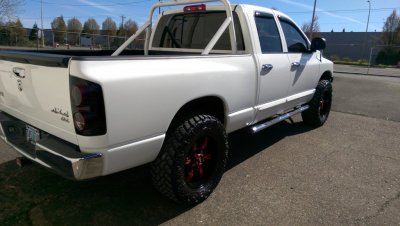

My rims came with two sets of accents, the red ones which you saw and then chrome painted ones. i knew i will never use the chrome ones so i stripped them down to plastic with scuff-it and painted to match my truck. Really love the look of the paint matched white accents and never seen another truck with it on a rim like mine.

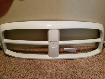

I believe this is the point where i decided i was gunna start to ditch all my chrome and i started my grill project. i knew for sure i wanted to keep the EPIC cross hair grill because IMO there is no better grill, painted white and do black mesh inserts with a black RAM head so i started with ordering a paintable grill and the inserts i wanted. The grill came from rockauto and the inserts are grillcraft brand i got off amazon due to no shipping it was the cheapest. I did set the grill up on my bumper to see the look of a black grill, not bad but definitely not the paint matched i wanted
ramportin1
ramportin1
Sickest member here
Jun 28, 2017
3,408
2,224
Oregon
So i removed the inserts from the grill, lined up my new ones and marked the holes id need to drill, drilled out the holes and had my brother meet me at his shop so i could paint it. This is when i found out how off my paint is from brand new PW7 bright white lol, i mixed the paint to PW7 and test sprayed a paint strip, it wasnt even close, i guess 9ish years of neglect will do that :bawl:. So i had to accept that this was out of my skill level and asked my brother for his help in tinting the PW7. It took about 7 different tint jobs to get his OK then i painted it. Came out flawless! So i let the grill dry for a couple days to be safe, then installed the inserts and put on the truck. Completely changed the look of the truck for sure!

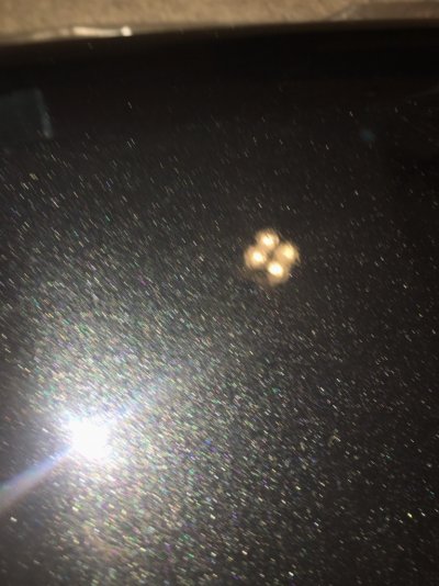

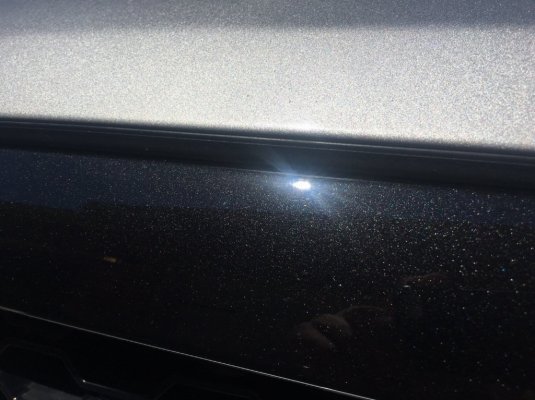

After some research on here i found people spoke highly of a paint company called automotivetouchup. i only need a small amount of black but i wanted a cool black, something a little unique vs just plain black so i went to there website and ordered some RAM PXR i believe is the code "brilliant black pearl." SUCH a beautiful paint IMO and dang did automotivetouchup do a fantastic job. i sprayed a test strip and held it next to my cousin in laws brilliant black pearl RAM and it was spot on! So i took my dremel and carefully power sanded my emblem down, AP then prime and painted. PW7 bright white back plate with brilliant black pearl RAM head

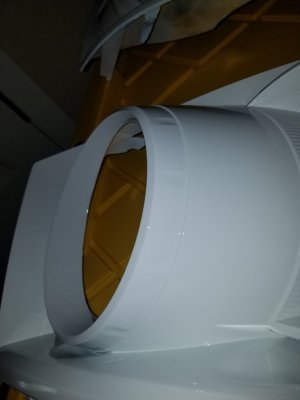

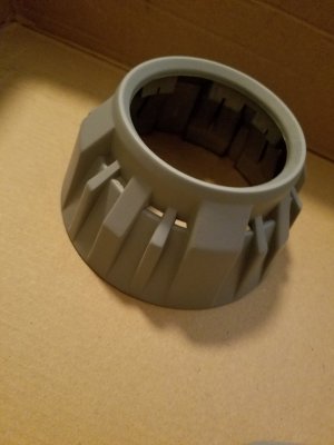

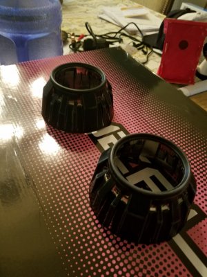

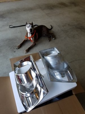

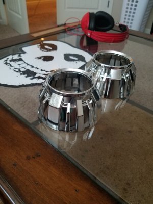

Now during the new grill process i also decided i was going to do some custom headlights to match, same color scheme bright white a brilliant black pearl. So i ordered some replacement headlights, baked em open and went to work. I never did this before so i did quite a bit of youtubing until i was confident. I then hit up Jeremy and put in a order from retroshop for some morimoto projectors and gatling gun 2.0 shrouds and morimoto H1 5k bulbs. He was super cool and helpful and shipped me everything immediatly. Highly recommend Retroshop as his customer service is top notch.

ordered more paint from automotivetouchup, sanded everything down, sprayed the AP, then primered everything, then wet sanded, then prep sprayed and started painting. Again bright white and brilliant black pearl with a 2k clear.
