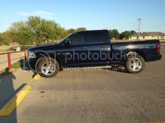

Is that a picture of a truck with them already installed?

Cool man thanks and its a picture of the truck at normal ride height I will put my before and after pictures on here
