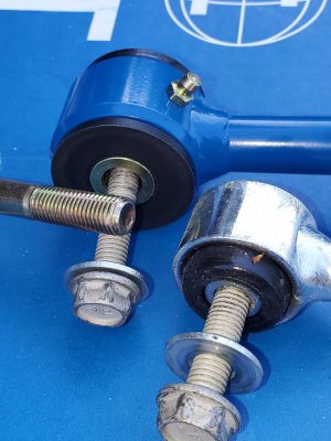

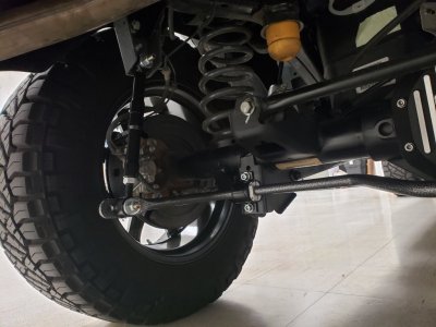

Installed it all today. The panhard bar is massive compared to the factory in weight and girth. I got it in blue with the end links (all Core) to match the truck. The drop link hardware for the lower end is great but the upper mount the bolts are the wrong size. Much bigger which makes sense but the upper uses the factory welded nut so I had to reuse the factory bolt which didnt thrill me. Diameter is smaller so there is some slop between the bushing. Not sure if it matters but Nick is working on it.20200428_182111.jpg 20200428_191218.jpg 20200428_191212.jpg

Drop links are massive as well. Much bigger than my BDS drops and factory drop links are tooth pics.
