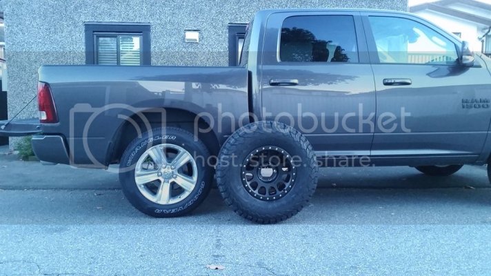

I went from 20" stockers with 33" rubber to 17"x8.5" Method NV (0 offset) with 35" tires. No rubbing, no issues with offset. Here's a comparison photo.
How much do your tires stick out past the fenders? I like the Method wheels. I'm torn between a set of Methods, Raceline Avenger SL, and a set of Walker Evans Racing wheels.
This image has been resized. Click this bar to view the full image. The original image is sized 1024x576.
Great picture man those look awesome!
