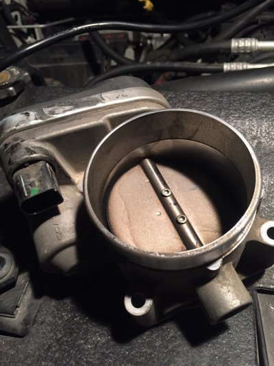

Just wondering if my plethora of CEL's are all due to a dirty or bad TB. ae001eae2c838a07fb18c981fa8eb106.jpg11e14d1cfaf9aedf9069028416fe6f12.jpg

I would definitely start with cleaning it but that looks more like a bad throttle body...

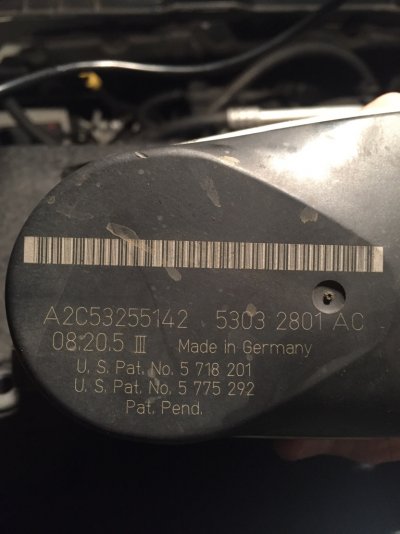

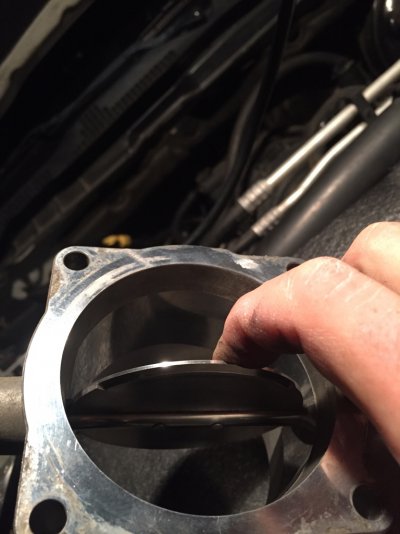

First things first. I unscrewed the throttle body 8mm bolts by hand (wtf to previous owner). Here is before cleaning.

Clean :)

Test drive = All good for now
Did a pull from stop and went 1-3 full band and no CEL. Misfire on #8 but injectors with almost 220k might be the issue there :)
I'll drive it to work tomorrow and report if I had to pull over and pull the TB plug or not :)

Sounds like you figured it out, needed just a lil cleaning. The fact the TB was on finger tight may have definitely caused some issues. Now that you might have to replace an injector, best to do em all, might even upgrade them to a higher CC flow (for future upgrades)
