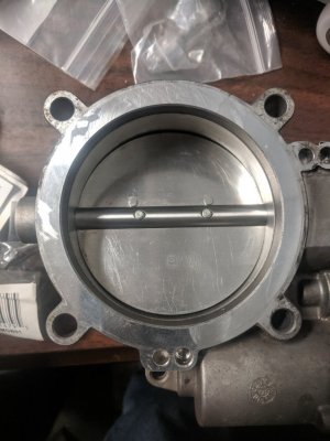

Thinking of swapping out the stock 65mm throttle body off my 4.7l wanted to see if the stock 5.7l throttle body would fit the 08 up 4.7l is a 65mm throttle body with 4 bolts. The stock 5.7l throttle body I believe is 75mm throttle body with 4 bolts anybody try this swap yet?.. thinking if it dose bolt up I would have to port the plastic intake manifold to clear the throttle body butterfly which would be fairly easy to do. Biggest question is will it bolt up?

5.7 TB is 80mm at the base.
"Below measurements are in inches"
TB sensor connection harness has 6-pins
(4) .320 diameter holes with a 4.44 BC diameter
(2) .242 dia dowel hole locators
(2) .224 dia dowel hole locators

Check with Matt at Moes a vendor on here,he used to carry ported late model 4.7 throttle bodies.I had one,along with a CAI /mandrel bent modded mid pipe and a Magnaflow hemi cat back dual exhaust.On the dyno,after 5 hours of dyno'ing it put down 244 at the tires,still wasn't great out of the hole,but above 3500rpm it would give stock Hemi's a good run,and if they were untuned,it'd pass them easily wide open.The horsepower gain was more in the 08+ head redesign not the throttle body so much.The motors gained a fair bit bit from the prior earlier 4.7's with the head redesign,but that also meant there's no off the shelf headers that'll fit them. Nick at AirRam used to have a blower kit for the earlier 4.7's,that supposedly would also work on the later 4.7's,but you'd have to do some research on that.The little engine loves nitrous though,i know of 1 later 4.7 that was running in the high 13's with a 100 shot of nitrous.Nitrous creates cylinder pressure ,which is torque,a small 75 shot won't hurt it,and it'll give you the tire spinning torque you're after
