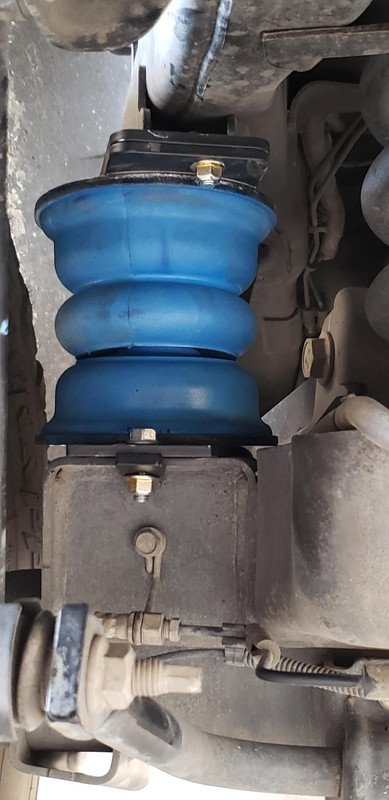

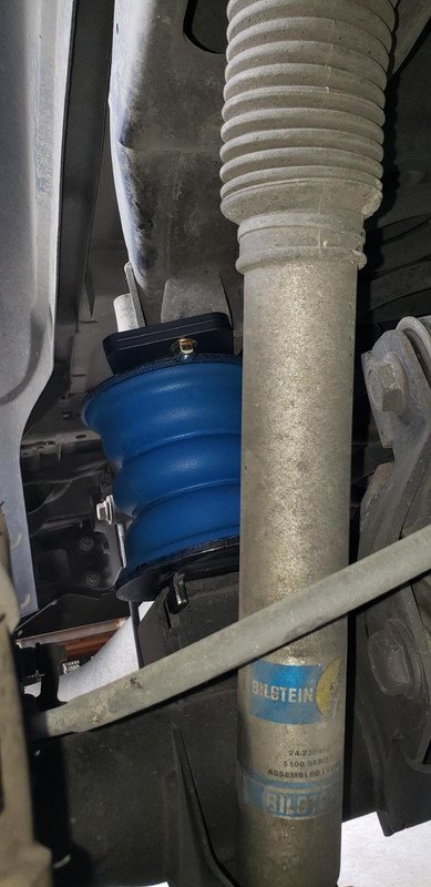

SouthTexas, you wouldn’t happen to have a picture of what they look like installed, the sumo springs, they are intriguing to me?
Although you probably won't need to, you can remove the bottom cushion(only 1 one bolt) on both sides in less than 10 minutes and can even do it without a jack out in the field if you have a way to articulate one side of the axle. These pictures were taken on install. I was not on level ground with the front of the facing downward so there is a little more separation than there is on level ground. They also sell .5, 1, and 2 inch spacer kits if needed for lifted trucks.
Driver Front
Driver Rear
Passenger Front
Passenger Rear
