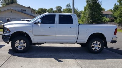

The rough Country Steering Brace will not work if you get the Thuren Front Say bar. The Synergy will and CJC Off road has them. With the 1" Font coils the Boogie Bumps really won't be worth the money. Track Bar Front and rear is worth it. Rear takes the Wag out of the Truck. Nice and smooth. Everything else you have listed is good also. I have everything that you have listed except Bumps and have the King 2.5 shocks.Truck rides and handles20190813_112554.jpg 20190813_112554.jpg
