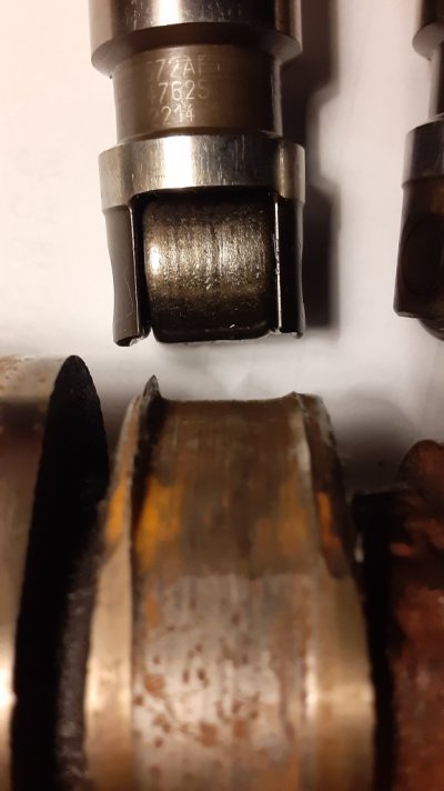

For reference, here's my lifter failure noise, also #3 interestingly:
2014 lifter failure
and here's the culprit:
Hopefully you get lucky and the noise is something else, but your friend should brace himself for the worst.
The next decision is whether to trade the truck in, sell it, repair it himself, have it done, or swap in a used or remanufactured motor. Good luck.
