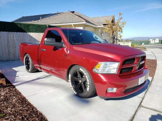

I have an IHR 4/6 but lowered to about 4.5/7. Not real happy with the Durango Airlift 1000's. They are too tall for the spring this short. They work great when I have a load or tow. If I air them up to 5 lbs the ride is harder than with no air but they do keep from bottoming out. Was thinking about the Timber Grove bags. Hoping to get a better ride when unloaded and still have the load to tow and haul.

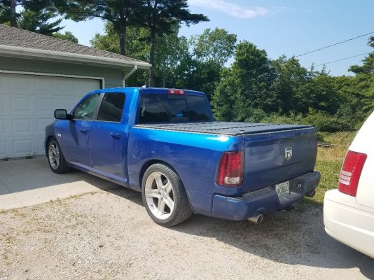

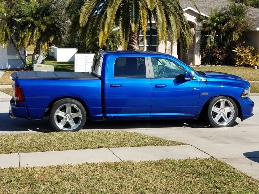

I have the timber grove 6" drop crm lowered to about 7. I have the viking double adjustable shocks and had to set the a little firmer but it rides great. I can't pull my 9k# RV with it this low so I raise it a bit when I tow.

Your trucks looks great! Did you have to do anything to have it ride lower or just less air? What are you using for air, Timber Grove auto level? Also what do you have your Viking shocks set to? I have them already. Did you lower your truck with the air bags or did you have it lowered with coil springs first? Wondered if you have something to compare the ride to. Thanks for the info.

I started with springs and air lift 1000. I did not like the ride as it was bouncy and bottomed out. I went with the auto level compressor system. It was expensive but worth the price. I just made a second set of links that are a little longer for towing. The shocks have the best ride at 4/8. I prefer mine at 6/10 or even 8/12 when fully loaded.

BTW, what size tires are you running? I'm running 285/50-20's and yours looks much lower. Maybe 265/50 or 22's? Here is mine.

I'm running 285/45/22 but will be going to 285/40/22 next set
