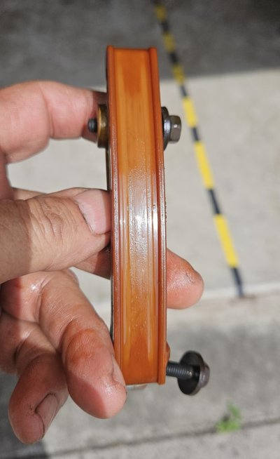

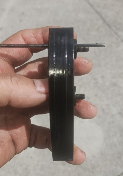

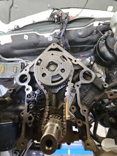

Here's my chain guides at 201K miles, hardly any wear. I could not find anything wrong with my chain, timing sprocket, or cam phaser either.
I went ahead and replaced all of them strictly because of my mileage and because I didn't want to have to go back and replace something I didn't do, since the engine was already open.20250920_130642.jpg
