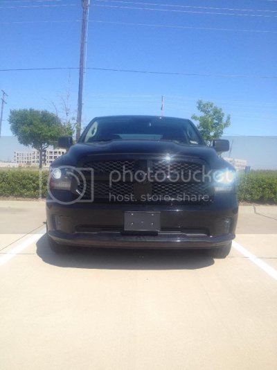

In case anyone was wanting to do the same....I found the Lamin-x wasn't the right size/ difficult to line up correctly.
35% tint from O'Reilly's- 8.99
After:

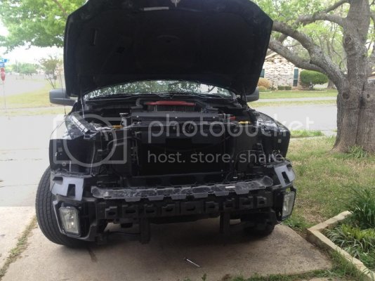

Either way. Simple enough. 8 bolts for the actual bumper and 4 bolts/clips on the fender liner on each side. And I got a cool pic of a naked truck

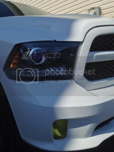

Tinted mine yellow without removing the bumper or the fogs...
Simply wash, dry, cut the film, spray with soapy water, stick the film, remove the air and water bubbles with a squigee/credit card, then heat up a bit with a heat gun! Voila!
Took me 5 minutes each sides!!
