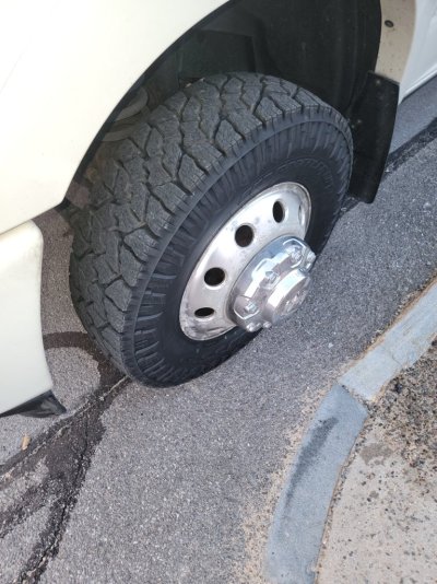

I bought my 2022 RAM 3500 single rear wheel gasser new in February 2022 and it came with Firestone Transforce HT, LT275/70R18 125/122S EV2440 DOT VN15 TH7 5021.
Yesterday one of the rear tires was flat, the other 3 tires had normal pressure. I had probably been driving locally a few miles with low pressure on the problem tire. I looked carefully at it, and it has small cracks in circle half way up the tire wall. The other 3 have similar cracks, but smaller. Using my (undersized) air compressor I got the problem up to 70 psi last night. This morning it was down to 40 psi. I called the local Discount Tire. They have the right size, in 3 brands: Cooper, Rocky Mountain (?), NITTL (?). Is any of these brands good? I assume the Firestone is not good. Any recommended brand? Should I expect to get the tires covered by warranty?

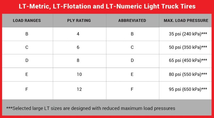

Did you get load e tires? Brand doesn't matter as much as load rating. It sounds like you need the 10 ply..

You got the tires replaced so that is off the table., Did you get money back from Firestone. My OEM Firestone's on my 2021 2500, were defective too, and I got a full refund as I only had 3000 klms on mine when I swapped them out for Goodyear Duratracs. Two year old tires that are surface cracked are a warranty claim, bad enough to lose air, they are actually dangerous. I would definitely be pursuing a warranty claim.
