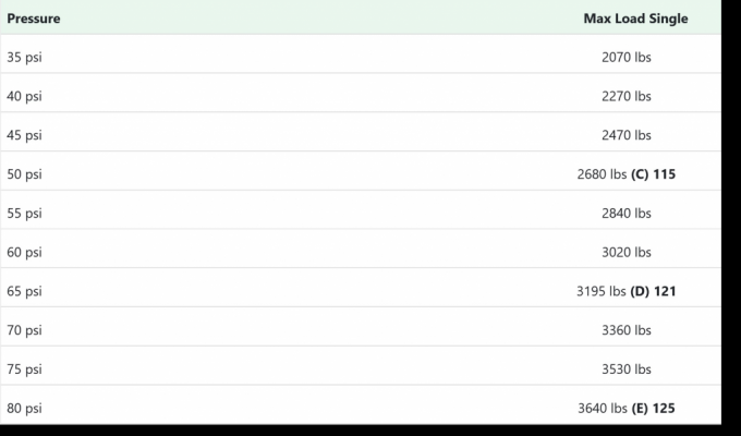

I have the OEM 18" rims with Duratrac 275/70/18 tires on my 2021 2500, long bed. I run 45 rear, 50 front and find it rides much better with a lot less air. From 65 rear to 55 rear, no real difference. Ride didn't improve much till I aired the rear down to 45. I used Alphaobd to fix the TPMS.
LT275/70R18 Goodyear Duratrac Tire Pressure Chart​
Corresponding tire load capacity at specified tire inflation pressures for LT275/70R18 tires.

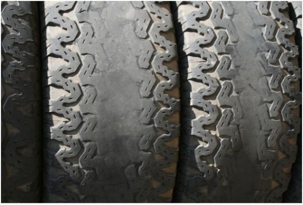

This will be the outcome for tire wear when running them at max psi when unloaded…
I've got 120K miles on my truck and just finished my third set of tires running 60psi front 80psi rear the entire time, unloaded 95% of the time and my tires wore perfectly evenly... nothing even close to those pics.
