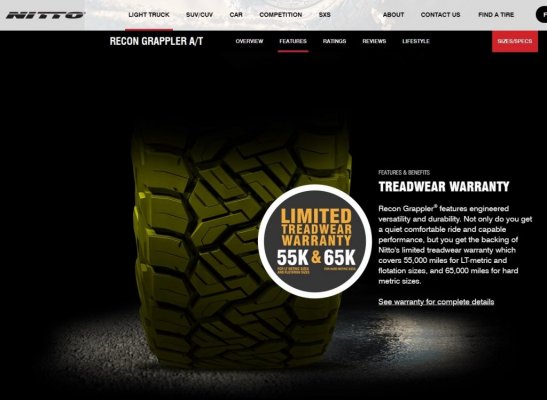

I like Nitto, perhaps you want to give them a try.
I have Nitto Dura Grabber - they don't warranty mileage on LT tires.
I tow a TT half of my mileage and got 40K miles on the Nittos.
Don't get me wrong - they are good tires.
The OP will be towing a lot.
