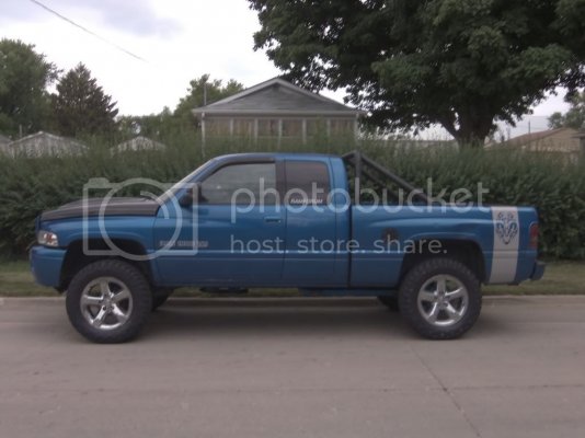

295/60/20 on factory rims Nitto Trail Grapplers

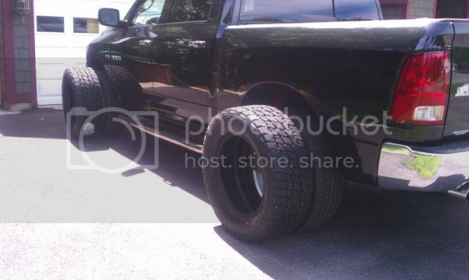

mikelr
Jul 23, 2012
99
2010
thats a 295? how much you spend on those? pics kinda small so i cant quite tell what it looks like
That pic is just my sig...... those are the stockers. I'm still waiting on my new wheels to show up before putting on the 295's.
mikelr
Jul 23, 2012
99
2010
To get an idea of what 295/60/20's look like next to stock....
