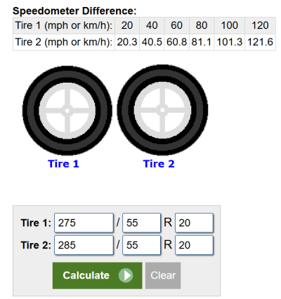

2023 echodiesel new tires placed dealer changed from 275/55/20 652 rev per mile to 285/55/20 643 rev per mile asked them to recalibrate for the differenr tire size

Most dealers can't, or won't, touch the Body Control Module to re-calibrate the speedo for tire size changes. It's a software/cost issue and the dealers are not willing to pay for the limited license from Stellantis last time I checked.
Some tire shops can re-calibrate and it may be worth your while to give some local shops a call and ask.
Lastly, you can license AlfaOBD, get an interface cable and a OBDII dongle and calibrate it yourself. AlfaOBD has a large number of other functional change options you can select if you so choose.

The difference seems to be negligible; I wouldn't worry about it. :confused:

@Dredger is corrent. The MPH reading difference will be minimal.
