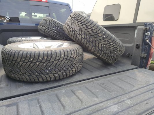

That is what I have been running in the winter for last 3 yrs or so, 20 in in summer, and 17's hi profile on mags the height is the same so every thing stays in tune. Being a old guy, I can't abide black steel wheels anymore. They are fine on a 2000.oo work truck.
Ice on the roads or streets are the problem here, snow is not a big deal here as a rule.

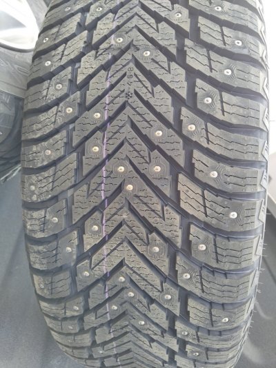

I'gve run studded snow tires all my life in the winter the Nokian tires are the best studded snow tires I have run.
However, anyone that claims to be able to out do a similar vehicle with chains without I'd have to see that.
I have run chains on plow trucks and tractors for many years I also find it disgusting that the p-- poor engineers didn't allow for chains on these modern trucks.
I have looked at some of the automatic chains but you don't find much for 1/2 tonners.
I have had my studded tires not make my driveway before, packed snow or ice under wet snow, and once while it was still raining on top of ice. Had to back down with my chained up Chevy with a load of sand in the sander for the Dodge to get the rest of the way up. I'll admit that I couldn't walk on the driveway either that day had to get in the ditch and stomp down into the snow still left.
