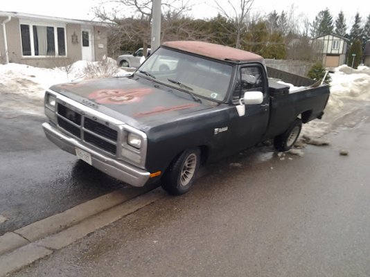

Does anyone know what the biggest size tires you can put on a stock height 86 d100 is? The tires that are in it now make it look like a fat kid with chicken legs

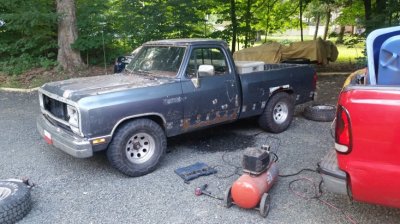

I just installed 33s on a stock 88 d100 with drop shackles in the back lowering it 3 inchs with minimal rubbing
And what - precisely - is the ACCEPTABLE amount of, tire "rubbing?" :hmm:
I would run 32's with an un-LIFTED Gen.1. I wouldn't LOWER one for any reason, and I surely wouldn't go 33's on one that has been lowered. That's a disaster waiting to happen. :eek:

The only rubbing I have is when I hit a bump it rubs on the front part of the fender which I solved with a angle grinder
