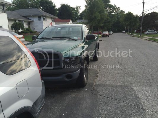

I have the bora 2" spacers. I did this when I put on 2" fender flares to cover up patch work on my bed wheel wells. That manufacturer suggests NOT using locktite. He suggest retorquing the spacers after 50 miles.
These pictures are stock 17" steels with the 2" bora spacers on and the 2" fender flairs:

Looks nice. I only mentioned loctite cuz I read that on a lot of jeep forums. I have a hard time deleting almost double the price for the BORA ones, since they're fundamentally the same thing as the ebay ones. Ebays aren't anodized, but are still cnc billet aluminum, same grade as the bora ones. What's the difference in the two other than the anodized part?

The only difference for me when I was looking was, I'm afraid to get a Chinese knockoff with bad quality control. I don't want them to break while I'm on the road. I pull a trailer with my motorcycle, imagine it failing at that point?
I'm happy with the Bora's, they have a lifetime warranty, and made in the USA.
