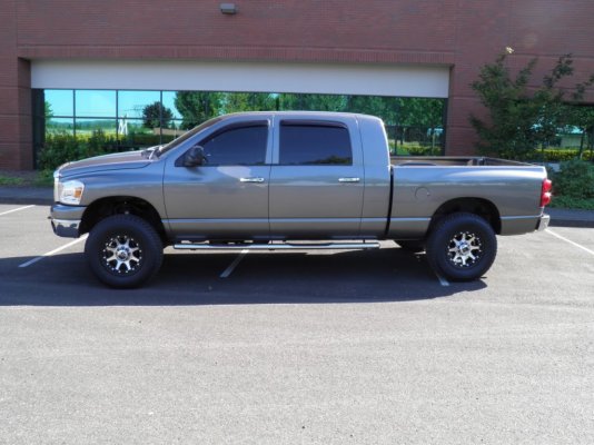

I did a 18" wheel & tire upgrade on my 2007 MegaCab 1500. I changed the wheel offset spec from the 43MM stock spec to a +18MM spec. The aftermarket wheel was also a 9" wide wheel which was 1" wider than the stock wheel.
This combination, with all the sizes and specs combined, worked well. YMMV
