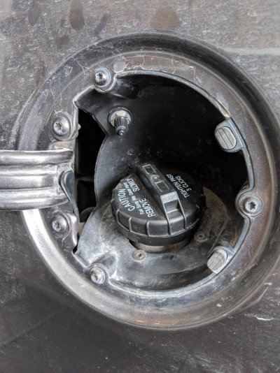

I really enjoyed having the airlift 1000. They've been great for me. Takes the squat out with my small trailer and whenever I load the bed heavy. Keeps the factory ride quality when inflated to only 5 psi.

No I just use a portable compressor or my compressor in my garage. I teed the two together and put my Schrader valve in near my gas cap.

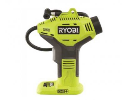

on a side note I was going to use this to manage the air pressure in the bags after I install them this spring
