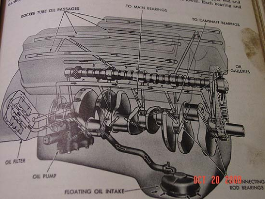

Every engine that i have had the pan off of had a screen on the Oil Pump Pick Up Tube.
Also the screen does not sit directly on the pan, it is elevated.
I am trying to picture how the bolt would fall into pan from the timing chain cover, i am not going to Google it.
This is an illustration of many different engines

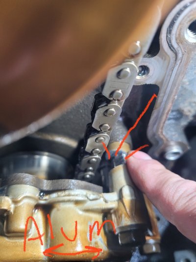

update: I saw the truck up on the rack today with the timing cover and chain / gears off. The issue is the chain ground off a good bit of aluminum oil pump housing which dropped into the oil pan which to my surprise is partly exposed (front end is open from top) . Shining a flashlight into the pan, you can see little flakes of aluminum. There is enough aluminum missing from the oil pump that I was convinced the oil pan should be cleaned out. It's another $600 :( but necessary now that I see the situation

Update: I went to look at my truck up on the mechanic's rack. The lower timing chain guide bolt broke off as did the lower piece of plastic and sleeve the bolt goes through on the guide. The crank pulley teeth are chewed moderately, phaser gears fine. He had the pieces of the bolt and acknowledged they are steel and cannot pass the uptake screen (thanks for arming me with that knowledge!!). His main issue was all the aluminum ground off of the oil pump case by the loose timing chain (see arrow in photo). I put a magnet on the case....it's not magnetic (the plate that faces the chain is). I did not know that you can see into the front part of the open oil pan with the timing cover and all off the truck). Shining the flashlight into the pan, you can see the glittery metal in there. I'm not saying the mechanic doesn't have a salt shaker full of aluminum dust but given that I see metal WOULD seem to be able to just drop into the pan from that housing, I decided to bite the bullet on the incremental $600 to have him remove and clean out the pan. Thank you all for the helpful information
Now that we know the issue,you're mechanic is probably right and the pan should come off for cleaning.I'd even ask him about washing out the inside of the crankcase/engine as much as possible to,when he has the pan off.When it's back together use some cheap oil,and change it in about 75 miles and cut open the filter at the same time,if the engine still has aluminium floating around in it,you should be able to see it in the oil and filter pleats if you cut the filter open.
