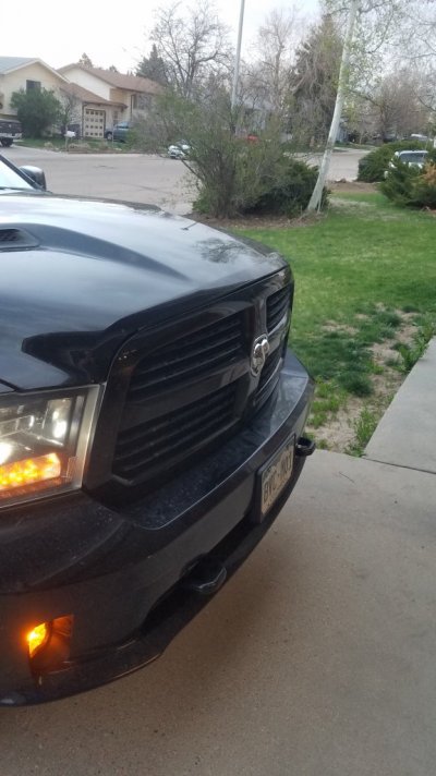

So I took the slats off the grill because the weather is finally nice enough to do some painting and color match them and it actually doesn't look half bad without them. I'm actually not in a hurry to put them back on. It's kind of wierd looking but also sort of cool. I dont know yet. But one thing is for sure, never again chrome!

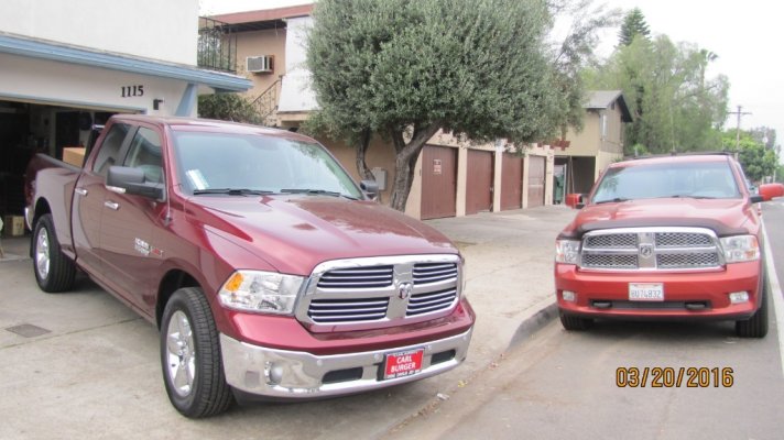

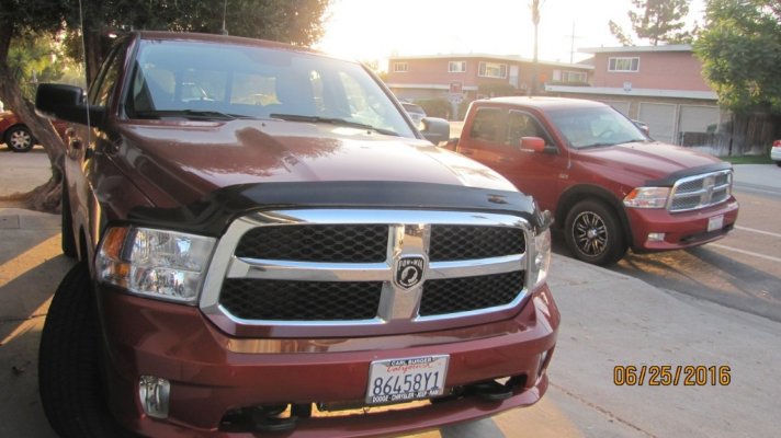

When my 2016 factory ordered Ram 1500 Big Horn arrived
I knew that i was going to de-chrome it

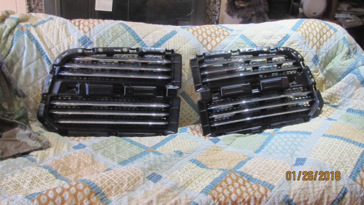

It came with the sports grille & i talked to the body shop that i use & told them that i would like to change out grilles.
He knew a dealership up closer to Los Angeles that he could order parts through & get delivery quickly.
He ordered a 2nd grille & i did not care for it & sent it back
A second grille was ordered & delivered & i had it sent back
a 3rd grille was ordered & i liked the Inserts.
So i kept it & used the Inserts & the original grilles outer surround
Original Ordered Ram is in the driveway
2016 is in the driveway, after body work
