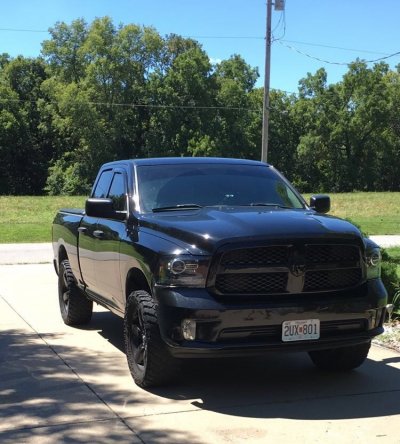

Vice Grip trick worked. Thanks for all the input guys.
Sitting at 39.5 in all corners and rides much better than stock with the bilstein's. Any idea how much it will settle?
